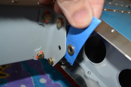

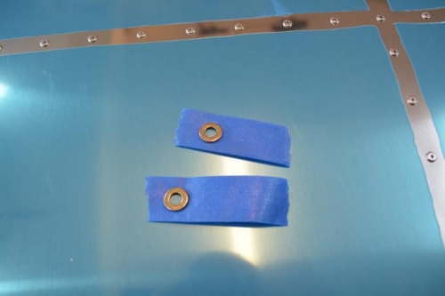

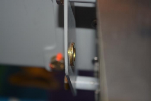

With the help of my son Benjamin and my wife Cyndi, I was able to determine the right washer combination for the hinge brackets. I noted it in the manual for future reference, but I used AN960-416 on the inboard side (2 places). To super glue them in place I used painter tape with a hole cut out in the center for the bolt. Then I place a small amount of gel type super glue on the washer face and used the bolt to center the washer as i slid it into place, using the tape to hang onto the washer. Once I got it into place the tape helped secure it until the glue dried and then the tape come right off. It worked very well on the first try.
Painters tape to hold onto the washer while installing it into place
View as I slid the washer into place
Washer glued into place
