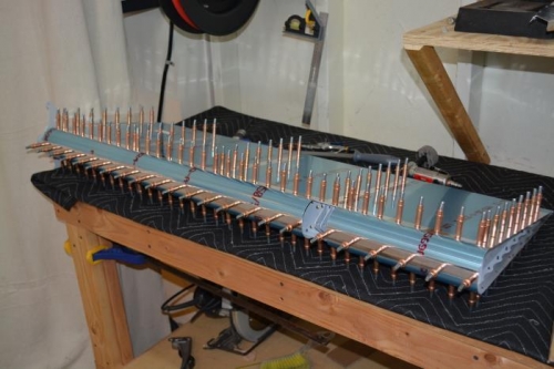

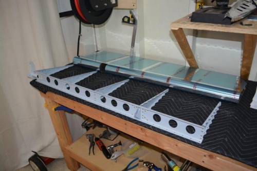

Finished up the rudder skeleton and attaching the skin. This went much smoother than the vertical stabilizer. All the holes lined up great. You have to hand it to VANS on the design of this kit.
I've decided to prime all the ribs, spars and associated hardware so that for any metal to metal contact at least on surface is primed. No plan to prime the inside of the skins unless I have scratches. I did prime the inside of the overlap of the leading edge of the rudder, so that one surface would have protection.

Rudder skeleton assembled and primed
Rudder skin clecoed in place and ready for rivets
