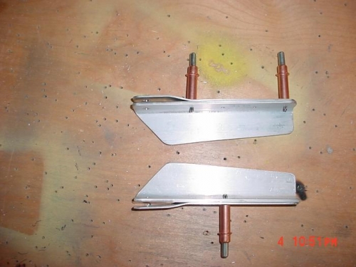

Brief Description:  REAR SEAT BELT BRACKETS
FABRICATE BOTH F857 REAR SEAT BELT BRACKETS. MATCH DRILLED TO F889 LONGERON. SPENT ALOT OF TIME LOOKING FOR THE ANGLE. THE PLANS CALLED FOR 125X 1X1.50 BUT IT WAS NOT IN THE INVENTORY LIST SO I HAD TO USE 1.5X 2. VAN SHOULD MAKE NOT OF THIS IT TAKES LONG ENOUGH TO BUILD A AIRPLANE WITHOUT WASTING TIME LOOKING FOR PARTS THAT ARE NOT THERE. STARTED MATCH DRILLING F826 AND 827 BOTTOM CENTER SKINS
