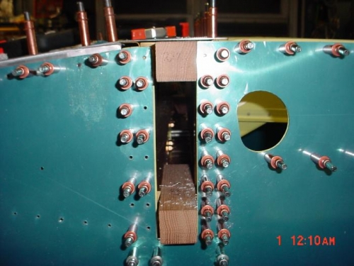

F823 SKINS
MEASURED BOTH WING SPAR DISTANCE FROM FRONT TO REAR SPAR TO POSITION F815 RIB TO F804 BULKHEAD. MINE CAME OUT TO BE EXACTLY 26.5 IN. DRILLED F815 RIB TO F804 BULHEAD AND INSTALLED KEEPER RIVETS ON BOTH SIDES. STARTED MAKING REAR BEND ON F823PP SKIN.
