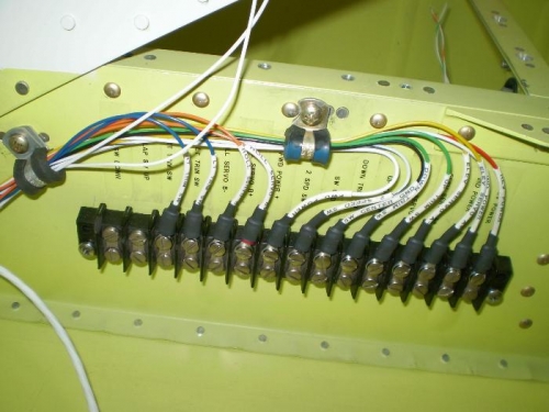

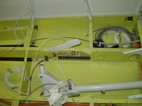

TRIM AND FLAP WIRING
MOUNTED TERMINAL BLOCK TO FLOOR BULKHEAD ON LEFT SIDE DRILLED HOLES AND INSTALLED PLATENUTS FOR ADELL CLAMPS. RAN WIRES FROM SAFETY TRIM CONTROLLER TO TERMINAL BLOCK AND INSTALLED WIRE ENDS.
