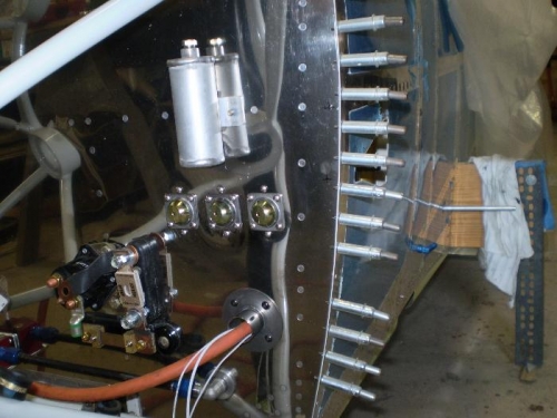

Date:  8-8-2010
Number of Hours:  6.00
Brief Description:  CABLE PASSTHRU
DRILLED HOLES AND FITTED FIREWALL PASSTHRU FOR THROTTLE MIXTURE AND GOVERNOR CABLES. USED THE STAINLESS BOLT ON TYPE INSTEAD OF THE SCREW ON TYPE SOME ON VAF WEB SITE STATED THEY ARE EASIER TO REPLACE CABLES WHEN THE TIMES COMES. MADE A TEMPLATE OUT OF 063 SCRAP ALUM. TO DRILL HOLES FOR BOLTS. THE PAPER TEMPLATE DID NOT WORK TO GOOD.
