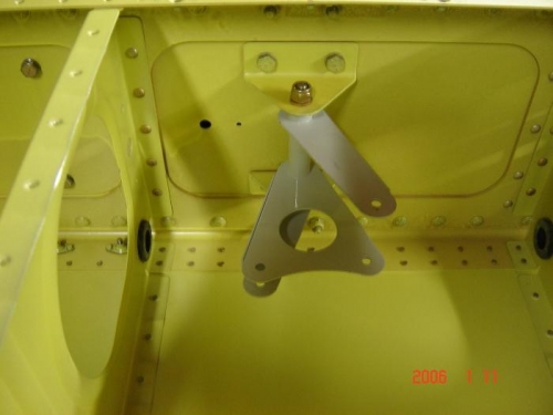

Date:  1-7-2006
Number of Hours:  6.00
Brief Description:  LH AILERON
MOUNTED LEFT AILERON AND INSTALLED SPACERS AND WASHERS TO ADJUST CLEARENCE.INSTALLED LEFT AILERON BELCRANK. INSTALLED LEFT AILERON PUSH ROD AND ADJUSTED TO CORRECT LENGTH AND TIGHTEN JAM NUTS. ALSO FABRICATED SPACERS FOR BOTH PUSH ROD AND MOUNTING BRACKET.
