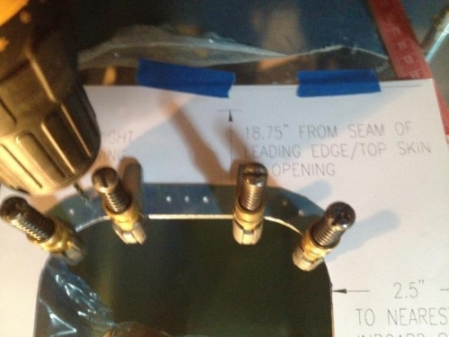

Making the Lens Cut-Out (LH)
Fit Template A back over the hole and marked the six holes as shown on the Template for the Retaining Strips screws.
Used the smal retainer strips in the kit as guide.
Final drill #40 each hole with the retainer strip in place.
