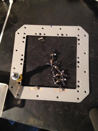

Brief Description: Installing Stall Warning System

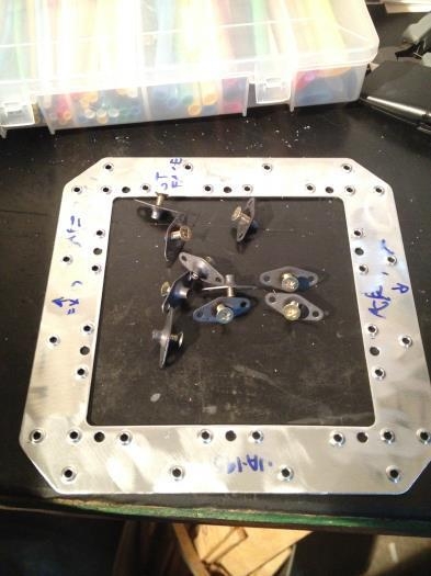

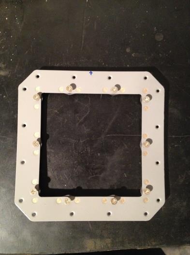

Deburred the edges and holes of both the VA-195C Access Hatch Doubler and the VA-195D Access Hatch. Dimpled the screw holes in the access hatch and access hatch doubler for the head of a #6 flush head screw. Deburred and dimpled the remaining holes in both parts. Cleaned with Mineral Spirits and primed both parts.
VA-195C Access Hatch Doubler ready for primer and nutplates
