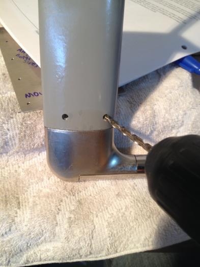

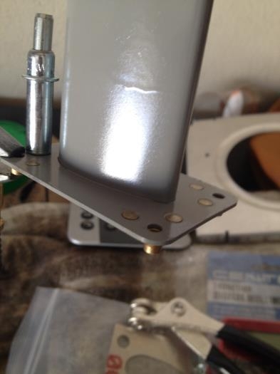

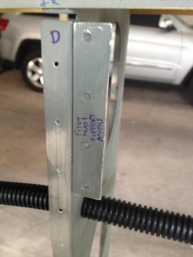

Installed nutplates on steel pitot mast. Match-drilled ans tapped the pitot tube attachment holes using steel pitot mast holes as guide. Deburred holes and edges on pitot backing plate. Fabricated pitot assembly support angle.
Riveting nutplates on steel mast
Match-drilling pitot head
Pitot assembly support angle
