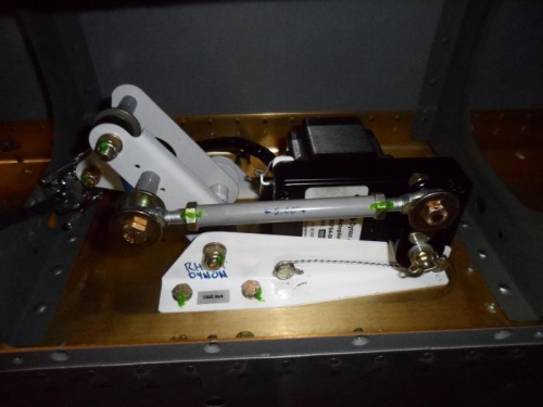

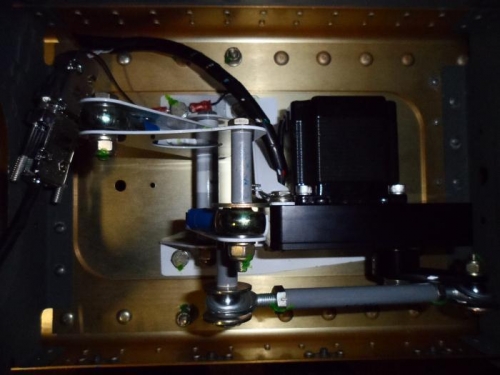

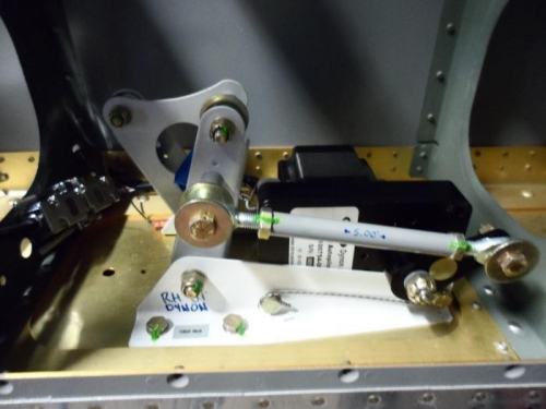

Final-installed assembled Dynon SV32 Autopilot Roll Servo in Right Wing.
AN Bolts torqued to34 in/lb and torque-sealed.
D9 D-sub connection and wires routed and secured away from aileron bracket and pushrods movement.
SV32 Roll Servo mounted in place
Top view of roll servo installed in RH Wing Spar
Notice green Torque-seal application
