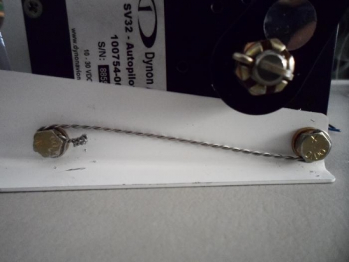

Assembled Dynon SV32 Autopilot Roll Servo with hardware provided and using the instructions from Dynon, pages 2 and 3 of installation instructions and illustrations
Torque-sealed all torqued bolts and nuts to specs.
Mounting bolts secured with safety wire.
Servo is ready for D-sub wire connection.

Safety wire in place around support bracket bolts (notice tightening pattern)
