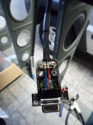

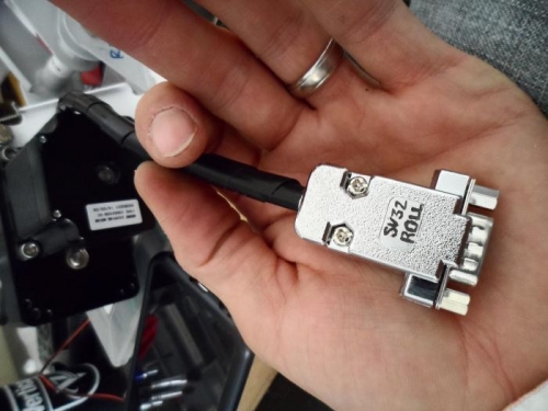

Fabricated the D9 Servo connector for the SV32 Autopilot Roll Servo using the servo's existing cables and provided D9 D-sub connector. Followed "Dynon SV## Servo Pinout (SV-NET-SERVO) page.
Reference: SkyView System Installation Guide - Revision W. Appendix C: Wiring and Electrical Connections (Image 3).
Securing wires with hot glue inside D9 D-sub connector
Closed and labeled D9 D-Sub connector
