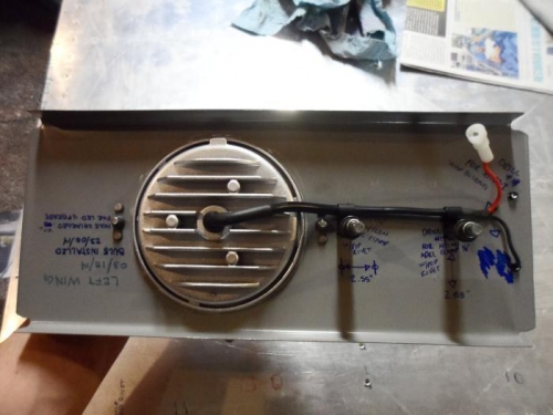

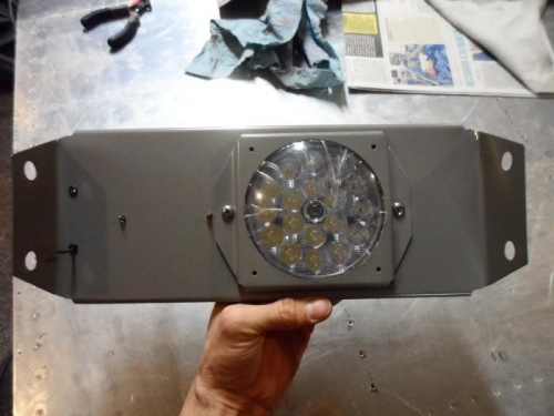

Brief Description:  Duckworks LED Lamp Upgrade (LH)
Enlarged .1" the perimeter of LH Duckworks HID Landing Light lamp mount hole to accept Handxen LED light. Drilled #19 the holes that will have two nylon adel clamps (size 1/4") and will hold the lamp's cable. Enlarged to #12 the two preexisting inboard holes for 2 SB187-2 Snap Bushings. These bushings will route the two ground wires (lamp's and cable shield) and will be connected to the screws that attach the Landing Light mount to the Leading Edge rib.
LED light mount rear view
LED light mount front view
