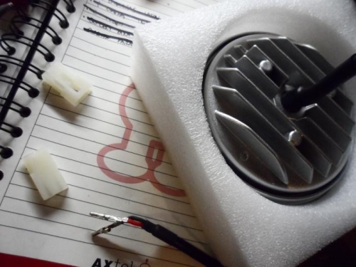

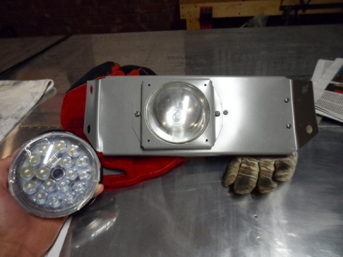

Began installing the upgrade from Duckworks HID landing light to Handxen LED landing lights. The upgrade consists of changing the HID ballast and lamp, using the existing Duckworks hardware and mounts. Since everything was already built and in place, only some modifications where required to fit the LED lamp in to the existing HID housing.
First of, I began fabricating the MOLEX connectors at the LED LH lamp wire terminal and disasembling the LH Duckworks Leading Edge HID Landing Light.
LED lamp (left) vs HID lamp (right)
MOLEX connections (update: single MOLEX used for hot (red) wire. Black wire attached to common ground)
