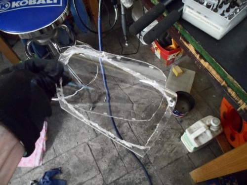

Laid Plexiglass lens over Leading Edge opening and traced a trim line on the lens approximately 3/4" bigger than the cutout on the LE from top and bottom, and 5/8" on the sides.
Trimmed the lens to the line using a cutoff wheel.

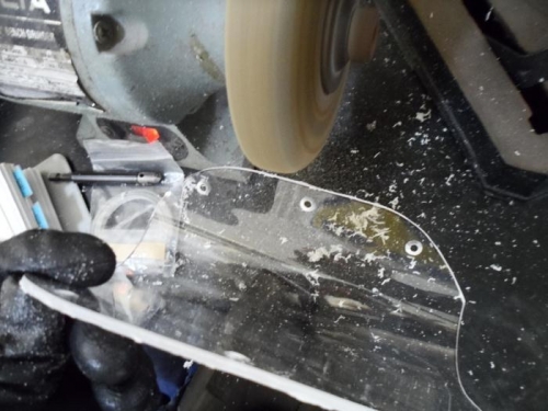

Finished lens by smoothing all corners and edges to avoid cracks using a 3M Polish wheel.
Rough cutting lens to traced line of Leading Edge
Smoothing all corners and edges with 3M polish wheel
