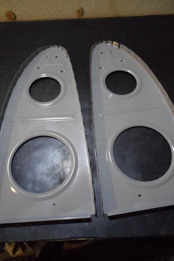

Primed inside faces of outboardmost LE ribs. These ribs will house the Duckworks HID Landing Light Bay, so different primer color was used (more reflective).

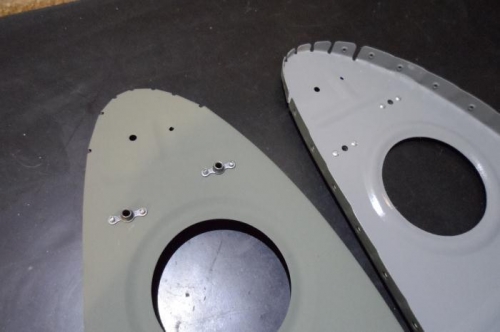

Installed the 4 10-32 (K1000-3) mounting nutplates using 3/32 pop rivets.
Primed inside web of LE ribs using Krylon Paint+Primer
Installed nutplates using blind rivets
