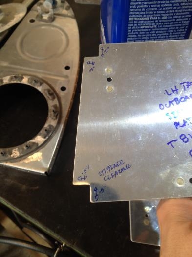

Began installation of fuel quantity sender plate.
Trimmed outboard sender plate to achieve clearance with tank stiffeners.

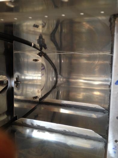

Routed outboard sender's wire through the modified snap bushings and vent line.
Trimmed vent line to better size.
Trimmed outboard fuel sender plate to clear stiffeners
Outboard fuel sender plate installed
Fuel vent line trimmed and deburred
