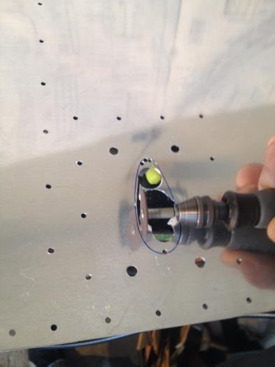

Cut and deburred hole for pitot tube mast in W-705L bottom wing main skin using the template drawn on skin. Deburred all edges after final test fit.
Hard to make the jump: Cut a hole in skin

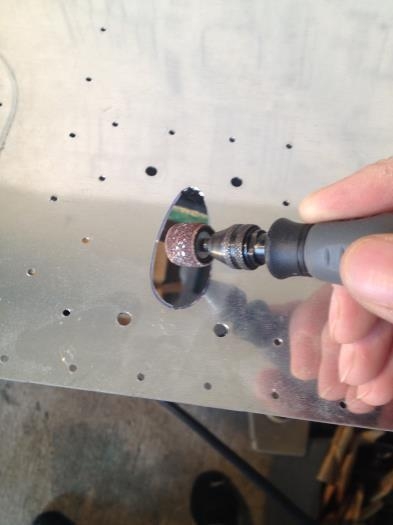

Fine sanding and shaping

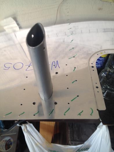

Test-fit. Like a glove!
