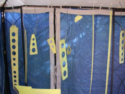

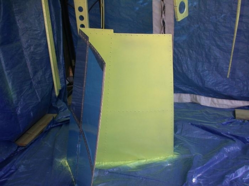

Brief Description:  Primed Vertical Stablizer

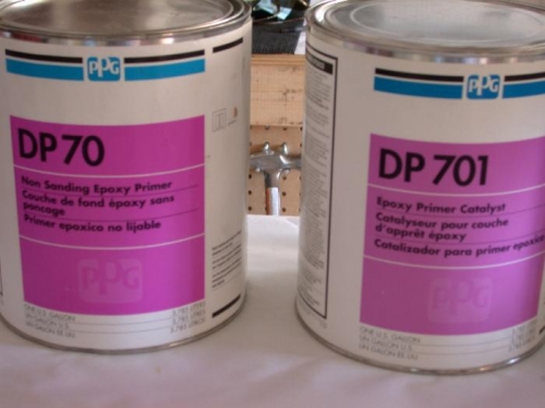

Primed Vertical Stablizer Skin and frame parts using PPG DP 70 and DP701.
See Web site www.txrv10.com for complete details on procedure.
All parts are washed, acid etched usin Alumni Prep 33, then Alodine in Alodine 1201, rinsed then Primed with Mil Spec 23377 primer, PPG DP 70 and 701 catalyst.
See link below...
http://www.txrv10.com/pages/primermain.html
Vertical Stablizer frame primed
PPG DP70 and  DP701 Primer
Vertical Stablizer Skin Primed
