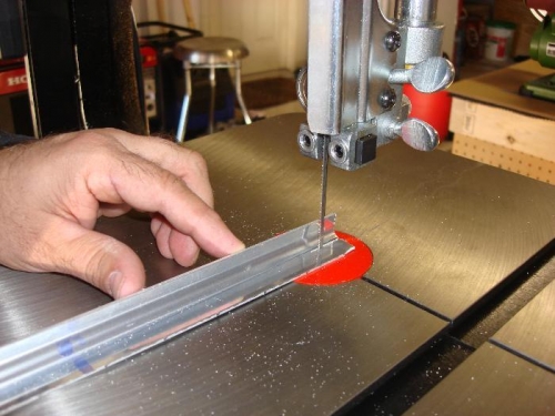

Cut Spar Caps. Would recommend not cutting as far as plans suggest to allow adding two extra rivets above middle rudder hinge.
I had the edge distance and ptich so I added them.
