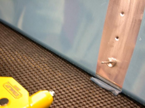

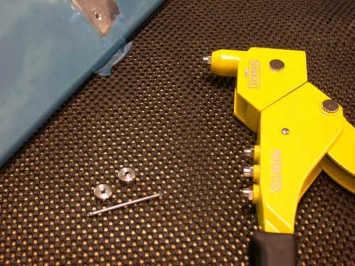

Dimpled the skin using the dimpler and the Pop Rivet dimpler on the leading edge of the skin where it wouldn't fit into the dimpler.
Pop Rivet dimpler Tool
Pop rivet dimpler inserted

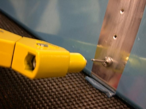

Put on the pop rivet tool and squeeze to dimple
