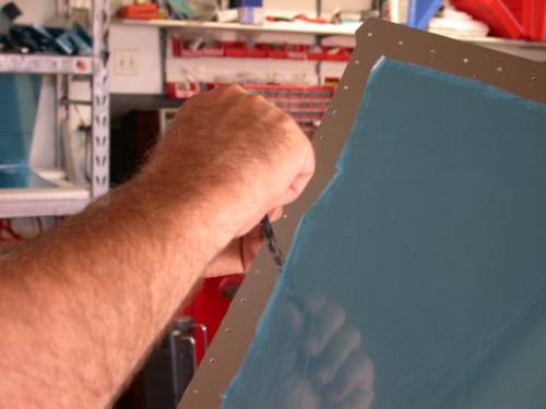

Brief Description:  Debur Skin after Final Drilling
Debur Skin using an oversize drill. If you have never used a drill to debur it's worth trying next time.
Just select an oversized drill and spinn it back and forth in fingers using very little pressure (don't push down).
