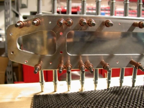

Brief Description:  Countersinking VS1008

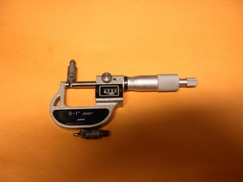

An improperly manufactured # 30 countersink
Caused one hole to be oversized.
The lowest hole on the VS1008 (Right Side) has been oversized to .134 by a bad tool sold by Avery Tool.
Tolerances for 1/8 rivet. Min and max are .125 to .135
Before I go any further I would like to say Avery Tool was great on replacing and doing whatever they could fix the product. Very happy with them as a company.
The VS1008 oversized hole (looking at picture) is on the bottom row first hole left of the furthermost cleco.
Actual hole size .134 Hole found to be acceptable for continuing

Incorrect #30 Counter Sink Measuring .134

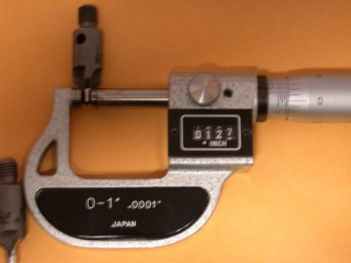

Correct # 30 counter Sink
