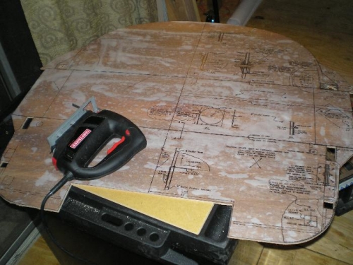

Cut Out Temp. Firewall
The first temporary firewall was warped and not as accurate as possible. Epoxied copies of the plans on flat plywood and made cutouts. Results were MUCH better. I will use this technique moving forward.
Temporary Firewall Complete
