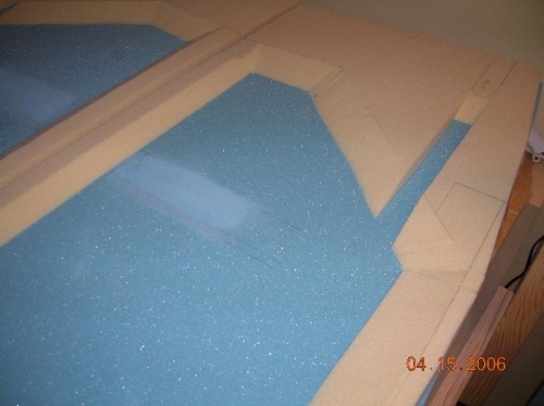

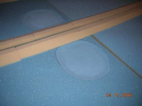

Dished Out Control Stick and Fuel Sight Areas on Both Sides of the Fuselage. Started taping under sides of foam and between pieces of foam so epoxy doesn't leak between foam and forms. Hopefully this will make it easier to remove sides of fuselage from the forms.
Room For Control Stick Use
Dished Out Area For Fuel Sight
