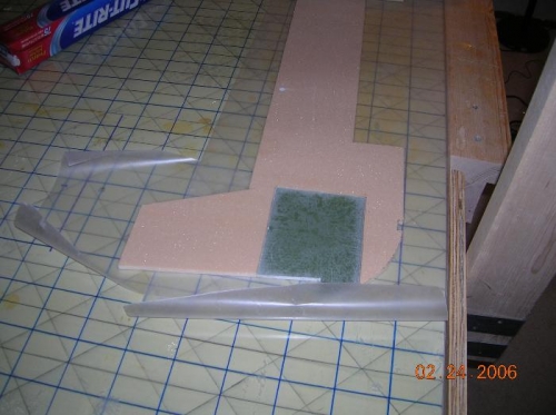

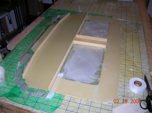

Front Side of Instrument PNL, and Landing Gear Bulkhead. Trimmed instrument panel and landing gear bulkhead.Sanded Front side of instrument panel, installed 1 UNI layer above leg openings and added stiffeners.
22 Layered Hard Point installed in foam
Instrument PNL Front, Stiffeners Installed
