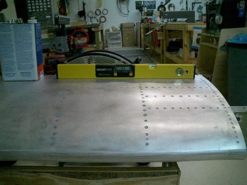

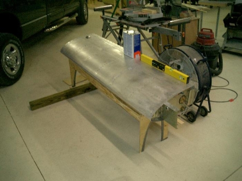

Brief Description:  Positioned tank for Fuel Guardian install
I got the proper dihedral (3.5 degrees per side) and incidence (1.5 positive from waterline) angles so I can simulate the tanks final position on the aircraft. This should give me a fairly accurate position for the 5 gallon mark I will use.
3.5 degrees
3.5 degrees
Ready for the water
Ready for the water
