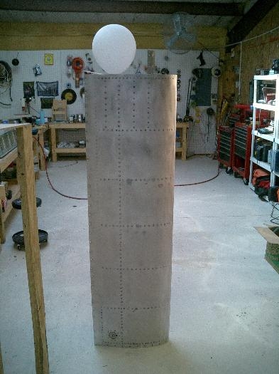

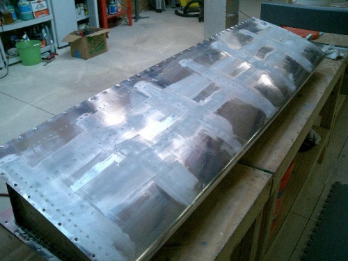

Pressure tested right tank, no leaks. Also finished smoothing the rivet lines and sanded the entire skin with 220. I'll alodine it and prime next week. Just need to finish the left tank and install the optical sensors in both.
Pressure testing right tank

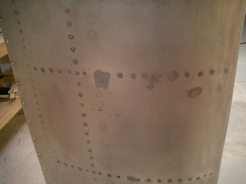

Filling rivet lines
Filling rivet lines
Filling and sanding complete on right
