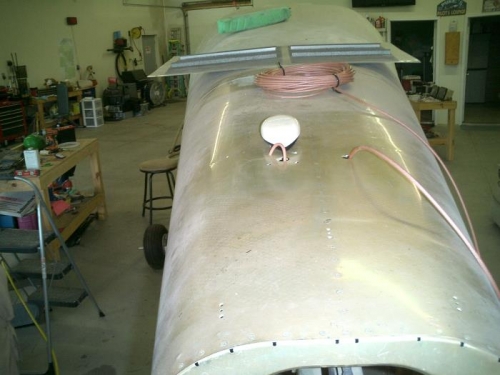

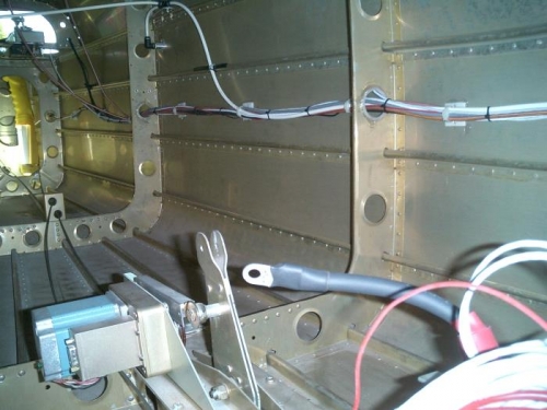

Brief Description:  Wrapping up tailcone wiring
Another update for several sessions over the last couple months. I was finally able to pretty much wrap up the rear tailcone wiring. This is great because I don't exactly fit well back there. I still have to connect the different antennas and such but they are all located and the mounts drilled. Now I will continue the wiring forward and then it will be paint the interiour, install the panel, and finish off the interior. I'm also looking at swapping the cowl for the Showplanes cowel that was specifically built to fit the setup I have. While not cheap it will probably easily save me 500 hours of work modifying the James cowl. The biggest thing that stopped me in the past from making this change is that I need to swap the spinner for the prop and I've heard that can be rather expensive but we shall see.
ADSB GPS on left, ELT right
Aft tailcone wiring buttoned up
