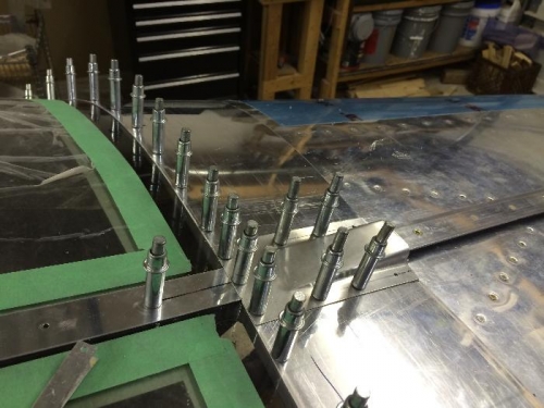

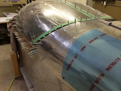

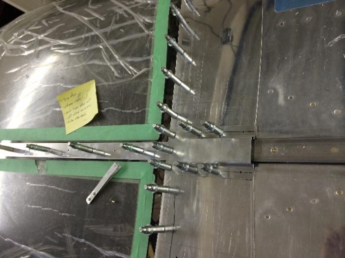

Brief Description:  Canopy wrapping up
Finished side skirts. Drilled aft skirts and front bows with 1/8" plexi bit. Drilled holes for canopy handle. CS where necessary. Drilled to 5/32. Polished all holes. Unibit for canopy handle. Cleaned bubble and put in house. Prepped metal for prime.
