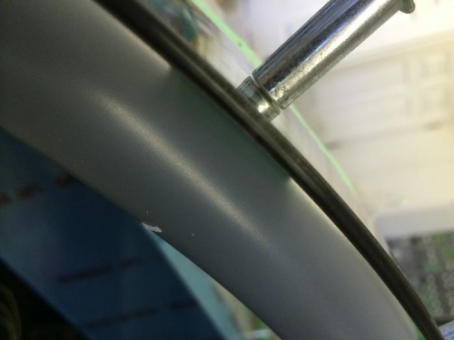

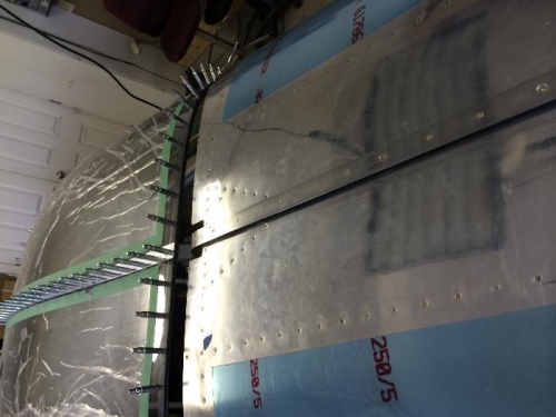

Drilled and countersunk holes in windscreen. Tapped holes in the roll bar. Setup the heights with the washers. I made 7 little z brackets to hold the windscreen down. Drilled rollers to canopy frame. Made a nutplate jig to mount the side slide rails. Mounted aft slide rail.
