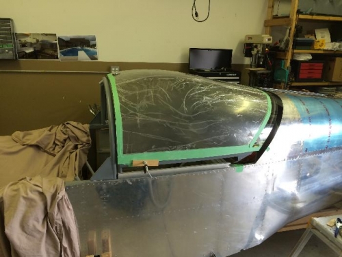

Brief Description:  Canopy problems solved
The bubble not fitting correctly was due to the center bow of the frame being mis shaped. I cut a template of mine and compared it to a couple other rv7's at the airport and figured out it was misaligned. I made some bends and things are looking a lot better.
