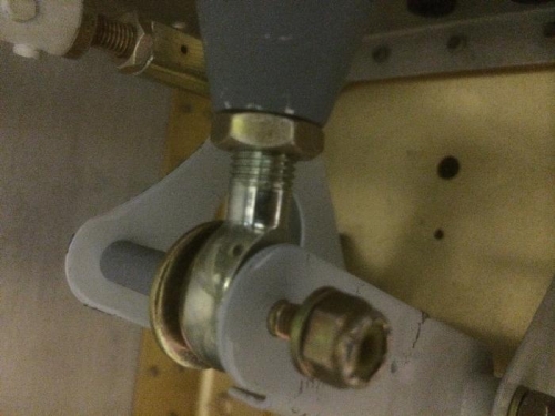

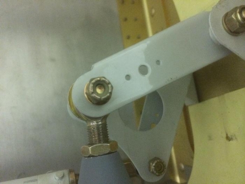

Brief Description:  Ailreron stops
Installed right side. Up on both is 30-31. Down is 17.
Tonight I determined my right aileron pushrod does fall off when jam nuts are loose and it is spun. i've ordered an extra set of jam nuts to install which will stop this from happening. Another option would be to rebuild the pushrod but I chose not to since I am getting the proper amount of thread penetration with the rod end bearings. The only reason one side falls off and the other does not is due to a manufacuring difference on the rod end bearings. Some of the bearings have a few more threads available. Look at pics.
