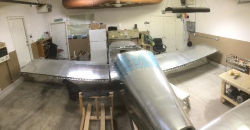

Brief Description:  Installed wings with Pete and Mark

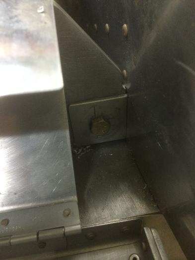

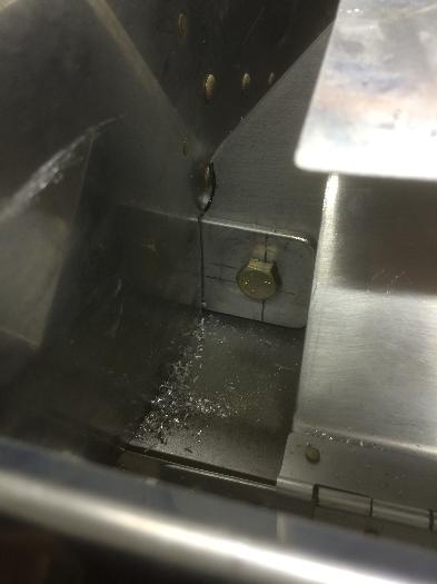

Wings had to go on and off a couple times to trim the rear spar for clearance of fuse rivet. About in 1/8" of misalignment on the forward sweep but it is consistent. The right wing had some twist. A max of .2degrees. We tried our best to compensate for it. Drilled the rear spars. Finished with a 5/16" reamer. The hole size was perfect. I read about some guys using a slightly smaller reamer. I had all kinds of room on the left wing in terms of edge distance. The right was a little scarier. The spar ended up higher on that side to get our incidence where it needed to be. I still ended up with slightly more than 5/8 edge distance on the closest side.
