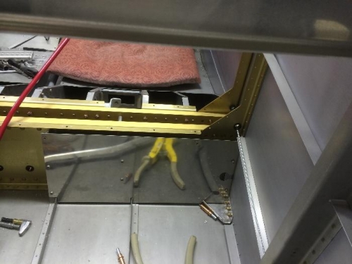

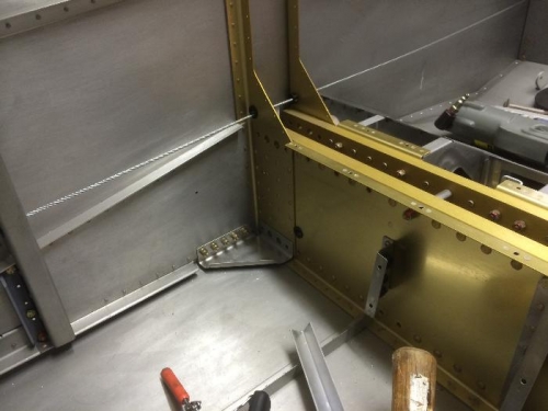

Brief Description:  Cleaned holes on main spars
The outer plate on the main spar was slightly out of alignment to the main spar bars. I carefully sanded to open them up. It did not take much and I did not bump the spar. Re-installed gussets. Checked drift pins. F-782A coverplate and support angle. Support angle is riveted.
