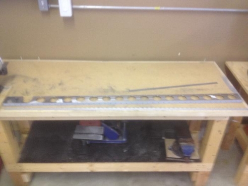

Number of Hours:  6.50
Brief Description:  Mounting flaps to wings
Drilled and countersunk flap brace. Primed mating surface on brace. Installed all pulled rivets. Gap between aileron and gap was perfect. I used the digital level to adjust the position of the hinge. Cut loops out in the center of the hinge to allow a center install of hinge pins. Installed nutplate to accept hinge pin holder.
