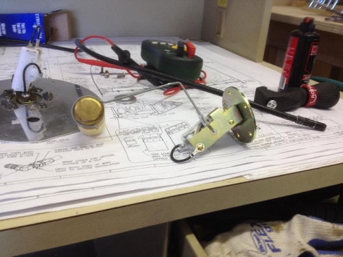

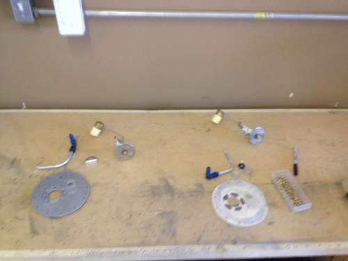

Brief Description:  Disassembled flaps and ailerons. Fuel pickup setup
Disassembled flaps and ailerons. Started working on fuel pickups and realized the one I created needed to be re-bent because the anti-rotation bracket forces them to go straight down. I also fabricated a second pickup as I am not going to install a flop tube. Bent the fuel sender floats. I setup so that they are just shy of the top and bottom of the tank. Prosealed everything. Torqued access covers. Torqued the screws in the top half of the tank.
Right tank fuel sender 248 bottom 35 top ohms
Left tank fuel sender 248 bottom 31 top ohms
