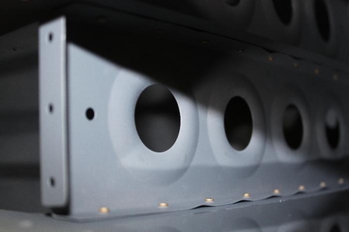

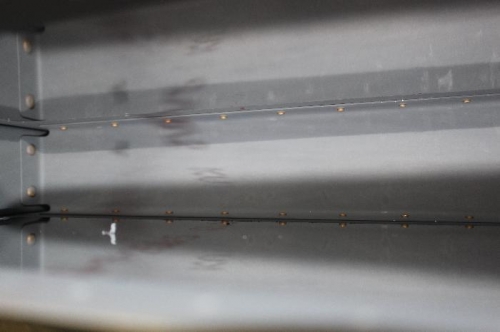

Brief Description:  VS skeleton riveting
Riveted skeleton in the morning. First time back riveting and that went well. Mark came over to help rivet the skins. Once we had it assembled we realized the top rib was sitting proud of the skin so it all shad to come apart to be shaved down. Then we starting pounding rivets and it went well. I was using arount 50 psi with a 3x gun. I see plenty of people using less but that worked for me.
