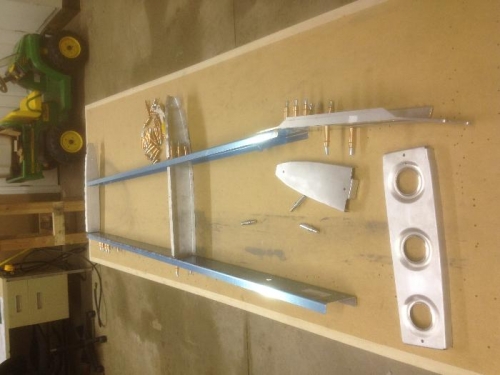

Brief Description:  Rib prep

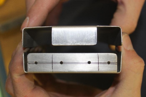

Need to countersink the two front splice doublers deeper. Flutted all of the ribs. In hindsight, get the flanges of the ribs square before fluting. Marked drill holes for the inner ribs that attach to nose ribs through front spars. Learned a good trick on VAF about transferring the front ribs tab dimensions onto middle rib because of the tight edge distance problems.
