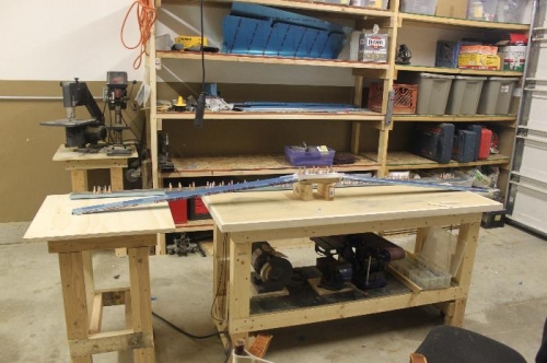

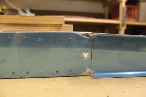

Brief Description:  Relief notches in two front spars
Put relief notches into the two front spars. The first one was a little crappy but then I figured out that the drill press would help. I really needed a centerpunch. Mark had a great idea about bending the tabs down and drilling before cutting them off. That worked great. The dremel with a cutoff wheel worked great for cutting. Then I bent the angles on the front spars. Clecoed it all together. Time to countersink the doublers but I need to pickup some scrap.
