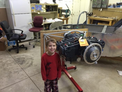

Brief Description:  Engine work. A couple steps back.

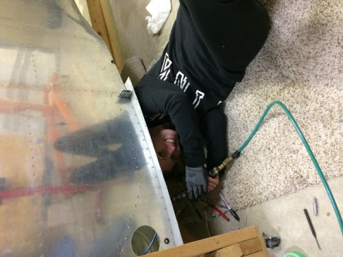

Reworked safety wire on prop governor. Hung engine on stand. I also determined the engine will need to come back off. The oil pressure fitting need to be rotated to allow more clearance with the motor mount. I also need to replace the star washers on the prop govenor because I foolishly reused them. That led to me realizing I need to replace the gasket as well because of the indents made in it. I finished prepping the second antenna doubler because I committed to two coms. Eryn helped me rivet them on. She operated the gun.
