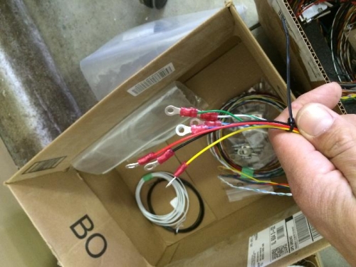

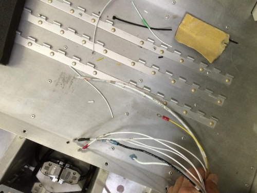

Brief Description:  Wired Landing Lights
I ran the wiring for the landing lights and the taxi lights. Landing light has one circuit for left and one for right to allow the vpx to wig wag them. 18g wire. The wiring is brought to the left bay then run out to the wings from there.
Installed connectors for heated pitot, roll servo and boost pump
