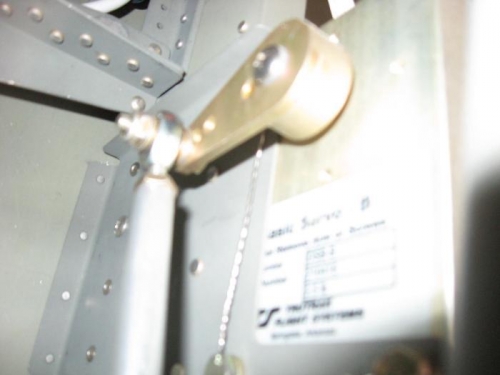

Lots of work done today. Corrected a problem with the elevator push tube where it attaches to the control stick assembly. I needed to grind away some metal on the bottom of the control assembly which interferred with the full up-travel of the elevator (Van's was contacted about this, and made the recommendation for the fix). Completed the wiring for the right wing root, with also included the DB-9 connector for the TruTrak roll servo. Installed the data plate on the fuselage under the left horizontal stab. Completed the Service Bulletin for the TruTrak servos by installing the correct screw in the pitch servo.

TruTrak pitch servo SB applied
