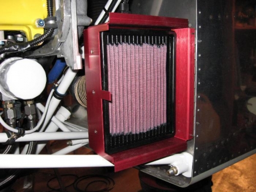

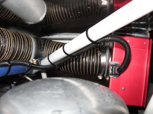

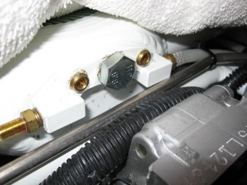

Performed the Service Bulletin for the E6/200 Engine Air Temp Probe Relocation. It was pretty straight forward. It worked out timing wise as I was just reviewing again the instruction in the Installation Manual for the Air Filter Box. So, after having moved the Air Temp sensor from the manifold to the area where the Air Filter Box will go, I switched gears some and completed the assembly portion of the Air Filter Box. Once that was done, I routed/secured the large air intake hose, and temporarily mounted the Air Filter Box to the forward edge of the side skin using the holes for the cowl attachment. This is a good area for the Air Filter Box, and it should not be much issue to permanently mount once the time comes to fabricate the mounting tabs for the cowling. Next, I mounted the Air Temp sensor in the top, center rear of the Air Filter Box. Completed the S/B by connecting the wires.
Plug installed in manifold where Air Temp probe was.
Hose routed and connector installed (looking from the top down)
Air Filter Box mounted temporarily in location
