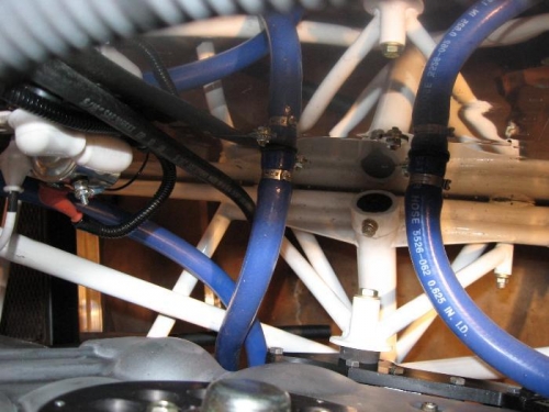

Brief Description:  Primary wiring forward of firewall

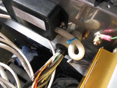

Drained the NPG+ coolant from the system in order to do the following: 1) Connect hoses to heater, 2) Shorten hose from coolant resavoir, 3) shorten and route coolant tank return line, 4) Perform Service Bulletin – E6/200 Engine Cover Plate Seepage which required loosening the right radiator for access to the top bolt on that side. Also drilled the hole for the main wiring loom and secured the loom through the firewall. Finally, drilled the hole for a pass-thru for the vacuum line. Busy day.
Primary wiring loom through firewall
Loom on the inside
Loom on the inside
Heater hoses connected
