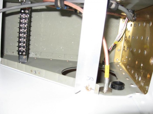

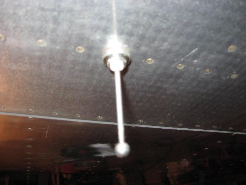

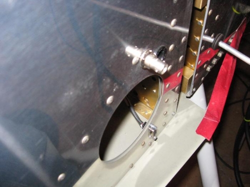

Started out today by drilling a 1/2" hole for the transponder antenna. Crimped the male coaxial cable to the transponder end of the cable. Next, crimped the coaxial bulkhead fitting for the ILS/LOC/NAV antenna wiring at the right wing root. Finished up the day by fabricating 2 mounting brackets out of .032 aluminum for the other wiring that needs to be detachable at the left and right wing roots.
Stubby transponder antenna located just inside the right main
ILS/LOC/NAV coaxial bulkhead fitting
Right wing root terminal strip
