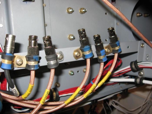

Started out by splicing the wiring for the AP Servo in the wing. This so that the wings can be taken off of the airplane. Cut a hole at the fuse right wing root for a bulkhead pass-thru for the coaxial that will go the Nav antenna. Added the radio stack trays back into the panel and worked on the mounts for the short coaxial leads from the back of the radios. Getting closer to running the final bits of wiring from the panel to various locations in the fuse (mainly the wing roots).

Coaxial's all lined up in a row with easy access
