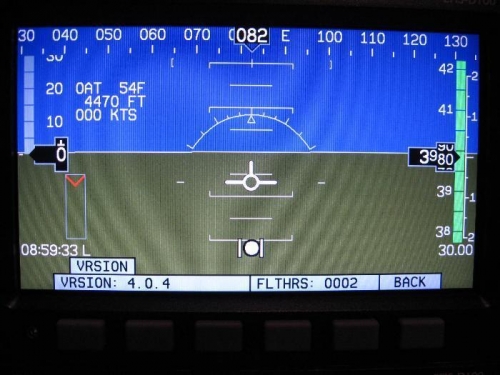

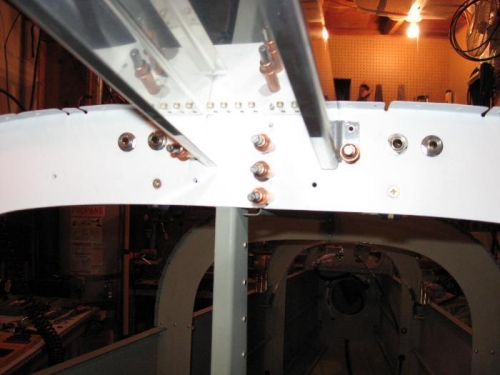

Drilled the holes in the baggage bulkhead (up top) for the headset jacks. Still need to complete the wiring for this. Turned my attention to the Dynon's. I have not yet seen an indication on the primary Dynon that the OAT probe is sensed. Reviewed the Dynon documentation about this and found that the probe requires firmware version 1.0.9 or higher in the EDC-10. My units were delivered with 1.0.8. So, uploaded the firmware version 4.0.4 and now the OAT is operational.
Headset Jacks located in baggage bulkhead (they're centered, the picture doesn't show that properly)
OAT working and firmware shown as 4.0.4 (that ripple in the picture is not visible on the unit)
