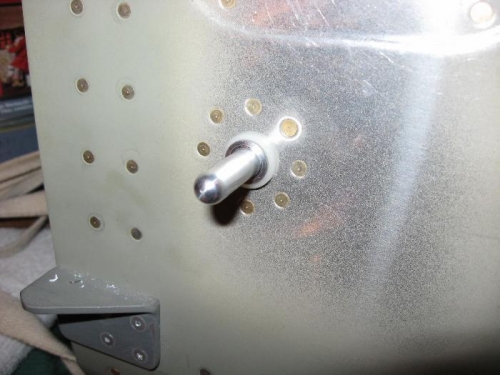

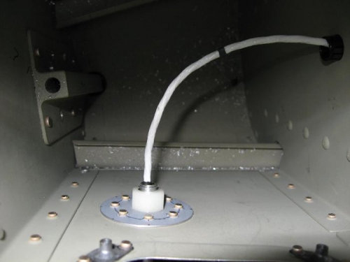

Mounted the Dynon OAT Probe in the tail section under the horizontal stabilizer (on the right side). This location provides for ease of access, and in close proximity to the Magnetometers to complete the mounting for the Dynon remote components. Wiring will be next...
Out of direct sunlight
Note the use of a reinforcement for the skin
